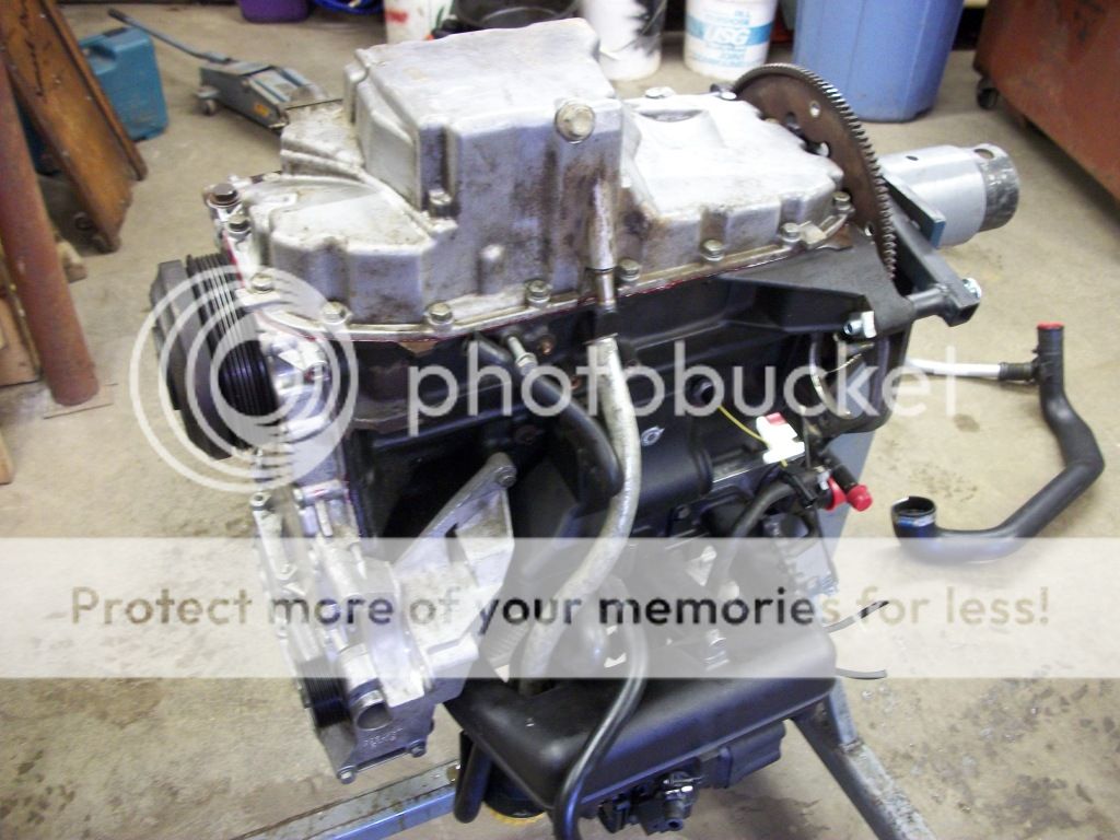

    i have the car high enough to slide the bolted up engine back under it, timing chain is good to go, i will tq the head in the car, gonna get a starter for it this week, hopefully you can do get the sway bar so i can get this thing together, 6 bolts for the cradle then 8 total for the brakes and struts and it's back to being one peice then install the radiator etc. btw it looks like the water pump wont have much traction without the ac compressor mounted in it, does anyone make an AC delete kit?

        Picked up the new starter motor 10 mins ago, gonna try to get this puppy bolted back into the car today.
        Pics from last weekend
