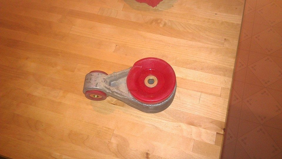

                      Tranny mount is in already, seems like a decently spent 24 dollars or so. Brakes will be a bit, can get the fronts in probably this week but i want a little more height for the rear install. it can be done with my jacks but a lift is preferred.
                        I'd need a big lift considering I lowered it like 5 inches with the Sti suspension ..lol
                        Polly trani mount FTW , how's it feel?

                            little more shaky, honestly it just made the shifting feel slightly cleaner. i read if i had a stock shifter it would stiffen up a lot more but mine is far from stock height
                              It should help your motor not twist under acceleration and depending on how your shift linkages are, it will keep you aligned for shifting under load. But that's only if you have solid linkages I believe not cable . Should put power to the ground quicker as the motor isn't moving first.. and then the wheels. Look out for extra wear and tear on your other mounts though. Having the one more solid will put more strain on the other mounts.
