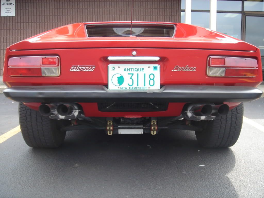

    1974 DeTomaso Pantera "L"

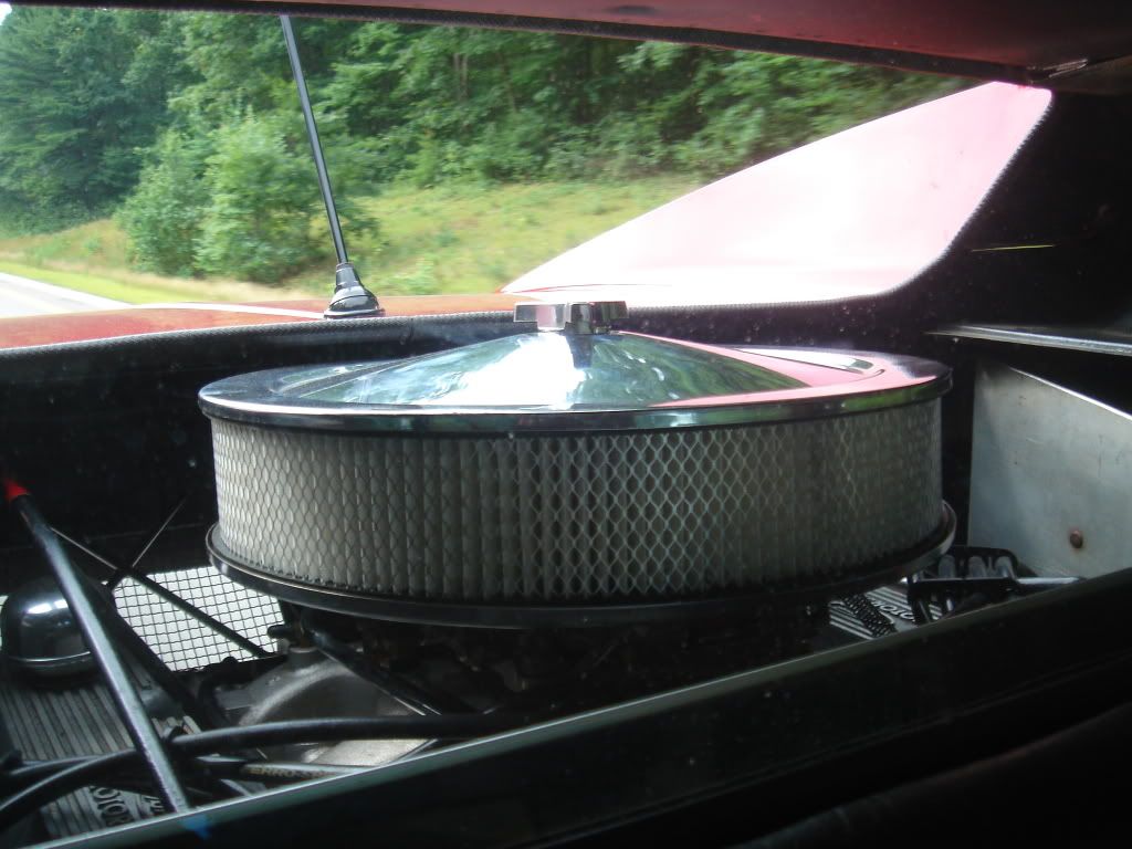

    The Engine
    NOS Ford Motorsport 351C NASCAR Racing block Casting #XE192540
    GF casting mark on top of block @ bellhousing
    4MA Crankshaft .010 under
    Std D0AE Rods , New ARP Bolts
    TRW L2416F Forged Std Bore Pistons .9.5:1 compression w/speedpro rings.
    Comp Cams 280 series 32-225-4 cam 230 dur @.050 , .530 lift , 110 deg lobe separation
    Comp Cams Hyd. lifters
    Trick Flow 1 piece 3/8 pushrods w/ new guide plates
    Crane Energizer roller rockers 1.7 ratio
    D1AE Closed Chamber 4V heads w/pocket porting.
    2.19 int and 1.7 exh? currently 64.6cc
    Cloyes Double Roller timing chain
    Milondon Hi Flow Alum Pump w hi flow 180 deg stat.
    Hi-volume oil pump, std pump shaft, yea I know I should get a hardened one.
    std pan w' windage tray and baffles. Using 6 qts
    Mallory Unilite distributor w/ mallory promaster coil.
    Timing at 10 initial , max advance 32 at 2-2500 rpm ( mechanical advance)
    Accel 300+ wires
    Weiand X-celerator single plane intake 4V #7517?
    Holley 700 cfm 4150 series double pumper w\mech secondaries, choke plate removed.
    Rejetted up on primary and secondary, also larger accel pump nozzle on primary
    Holley electric Blue 110gph w regulator set at 7-8 psi. 3/8 line.
    2 into 2 into 1 headers , 2'' primary tubes w\2 1/2 ' collectors. ceramic coated.
    Main rotating assy balanced w/ flywheel and centerforce clutch.
